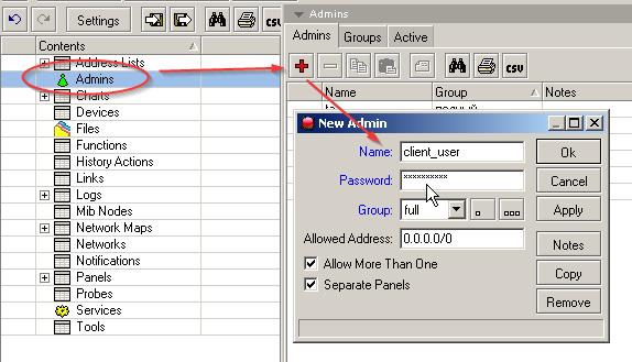

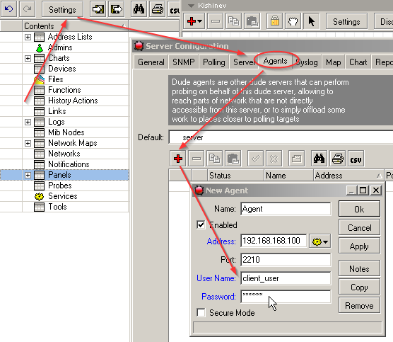

  1. You should connect to your RB750G running on a remote network (the new agent for a sample whith IP 192.168.168.100) from local The Dude client station.
  2. You should setup new user/password/ip for your The Dude server connection on the new agent - your RB750G ip 192.168.168.100 (for a sample client_user/mysuperpass).
  3. Disconnect from your RB750G ip 192.168.168.100 and connect to main The Dude server. Then setup new agent
  • Can you extrapolate on this? It sounds like you are suggesting I connect with my local dude client to the remote dude agent. This is exactly what I cannot do, and I don’t know why.

Here’s what I did:
Using Winbox, log onto the remote RB750
Set up a new user with full privilages
closed winbox
Open the dude, log onto local dude client as admin (logging on as remote user doesn’t work)
create a new admin, user name and password matching that of the new user I just set up on the remote RB750 (as per your instruction #2)
created a new agent username and password matching that of the new user I just set up on the remote RB750 (as per your instruction #3)
