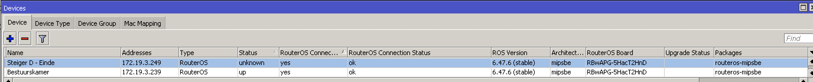

Dude setup and device status keeps/stays Unknown
I’m setting up the Dude server/monitor system to monitor my wAP access points. There is one AP that keeps the status “Unknown”. I don’t understand why. I’ve compared all the settings with the other AP’s and I cannot find a difference. What is determining the Status result? Which test needs to be passed to make the status set to Up?
The login name/password is correct, that is something I can see in the log file on the AP. And the other filled in fields show that the Dude can make a connection.
Suggestions?

It was not a real copy and past type activity, so the two AP’s are NOT using the same MAC addresses. From the Dude server I can IP/MAC ping the device, I can telnet into the device and I can see in the log file of the AP that the Admin can login into the device. Still a bit puzzled why this device shows status: “Unknown” and the other 10 AP’s show status “Up”.

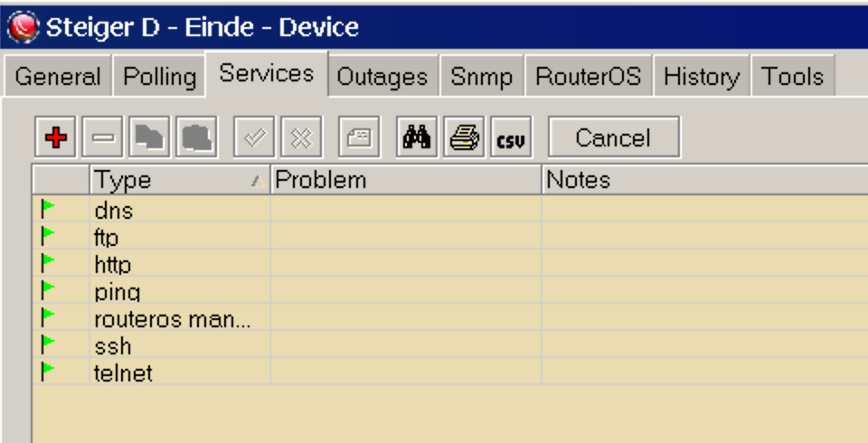

Found the solution myself. The services tab page was empty, so there was not something that the Dude server could check/test on. I presses the “Discover” button and the services were automatically filled in. Now the status is shown as Up.
