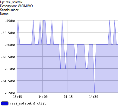

Wow 4 and a half years later and I’m still searching for a solution and came upon my own thread lol. I’m starting my build using v6 and so far so good with most things, but the problem outlined in my first post still exists with it.
After 4.5 years I’ve gotten used to it and can live with it, but if anyone knows the secret handshake to make this thing work as expected, I’d love to hear from ya.
PS, to my future self in case I look again some time in the 2020’s, hey dude!
Crazy stuff jmay, what I didn’t try was to fix graphing negative numbers, I just graph the negative number from my radios. Maybe multiplying by -1 is storing the previous value and screwing up your probe? Anyhow you can graph negative numbers so maybe that would work…
Ok I figured out the new dude could graph negative numbers after I posted this so I took out the multiplication to make it a positive and it seems to work fine now. I was using dude 3.6 originally which forced me to do it that way.
