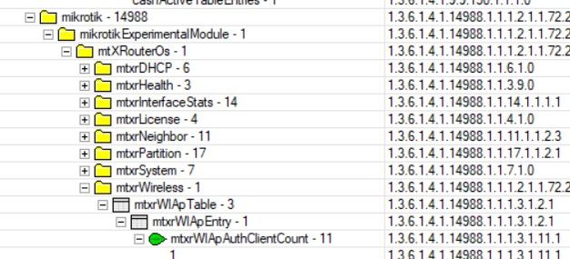

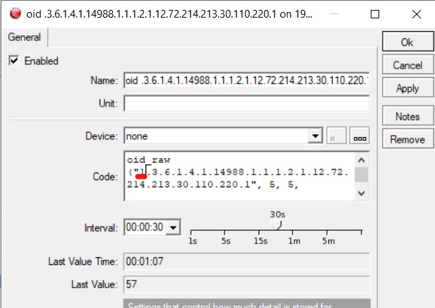

Well some lazy implementation.
Add Mikrotik MIB tot DUDE
Do a SNMPwalk on the MT AP.

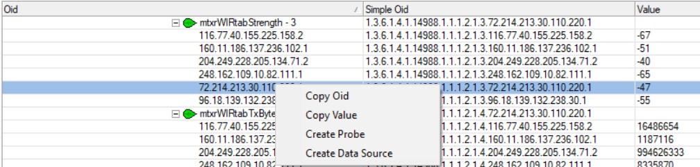

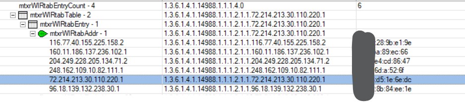

Find the registration based on the MAC address of the device

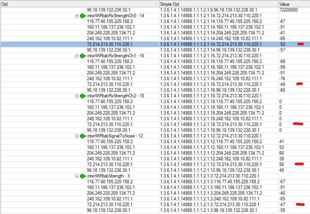

You get an OID number (tail is probably the decimal encoded MAC address)
Find the value you are interested in, based on that OID number tail as reference

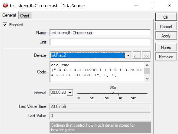

Create a data source (right click)
Edit data source by adding the first 1 in the OID 1.3.6… (it’s missing!)

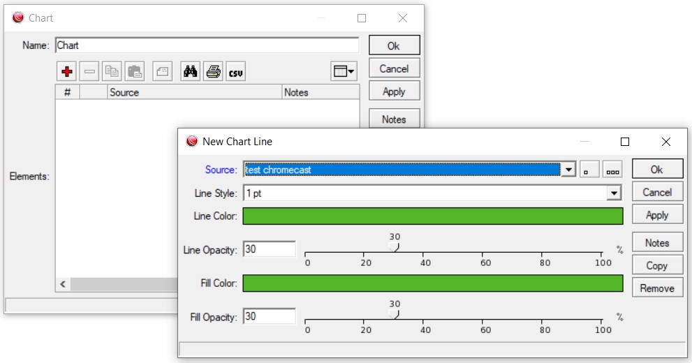

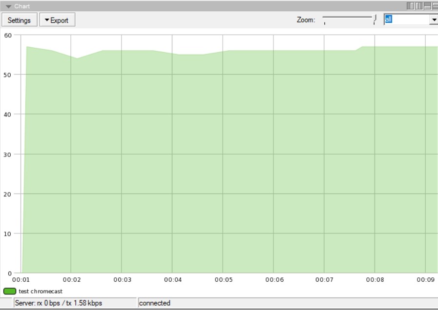

Make a chart with that data source
Edit data source by adding the first 1 in the OID 1.3.6… (it’s missing!) → value must change to current value with every “Apply”
Make a chart with that (renamed) data source
