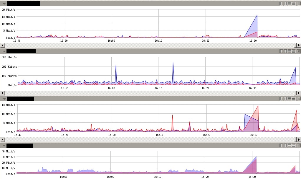

I experienced a strange ocurrence when I performed an export from a client and then from the w2k server The Dude server is running from. See the attached file for the blips that coincided with the two exports I ran. The links which graphed the blips are external links which the traffic would not have been passing along. So I was just wondering if anyone else has seen this behaviour when doing an export.
