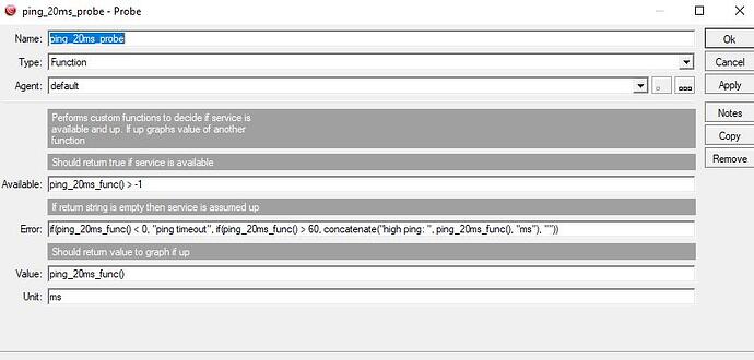

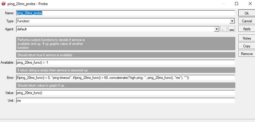

Can anyone tell me how to graph ping multiple devices on a single graph?
which function to use?
Either add a bunch of devices to a chart or manually build different ping probes with the IP address specified for the target and add them all to one device. Chart would be easier.
Please help me a bit,
i added this in “Function” with name RTT
Now what have to do in “Probes”? There are some blank rows to fill like Available, Error, Value, Unit… and…
Create a new probe, give it a name, select type function.
In available put your RTT function or call the function directly like below.
Do the same thing for error and value. Value is what is graphed.
I just took a guess as to how yours should look.
Available: RTT()<>“”
error: if (RTT()< 120,“”,“high latency”)
value: RTT()
unit:ms
Am I correct in understanding that each time the RTT() function is called, a ping will be performed? Is it possible to perform a single ping in such a probe and use its result in error checks, etc.?
My probe pings four times :frowning:
