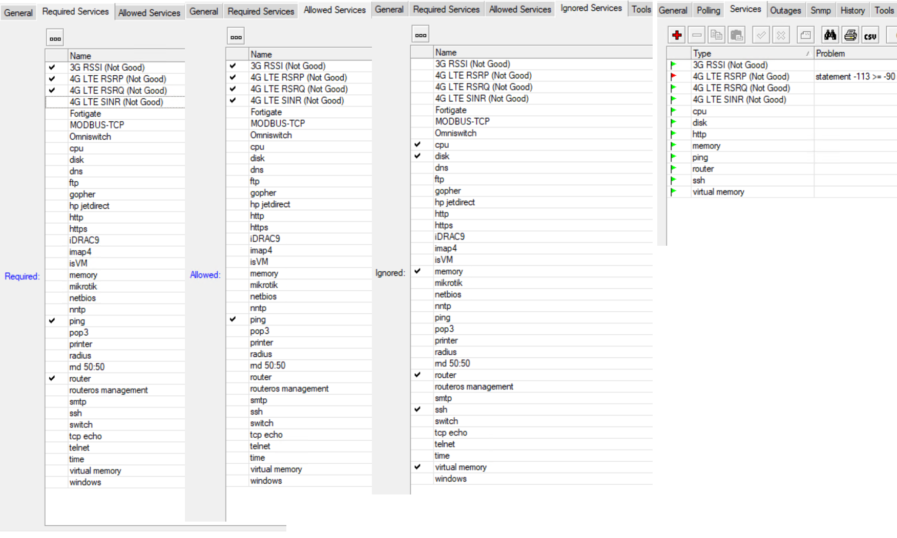

Here is example of problem. I have device with all discovered services, but I want to have only part of them in Services tab.
I noticed, what:
  • there is considerable (sometimes) delay between moment when you press Discovery button inside device “Services” tab and moment, when Dude remove all unwanted, but discovered services.
  • button “Discover” became “Cancel” when pressed, and does not revert back.
    Just checked full cycle: added new device by DNS name, does not press discover on creation. After creation, I did discovery, and it works as i want.
    Device type are set, device picture ok, required services are ok.
    So to draw a line: in Device Type:
    Required Services - check services which will stay in “Services” tab for this device type.
    Allowed Services - check all services, what can be discovered by Dude on this device type (device fingerprint, I think).
    Ignored Services - check all services, what should not be present in “Services” tab for this device tab.
But I still not sure, what my logic is correct. Why then we need Ignored Services at all?
I believe “Ignored” means those will be removed as probe if found. e.g. If it’s both required/available AND ignored, I believe it will use it for identification but remove the probe from device later. But didn’t test it recently.
