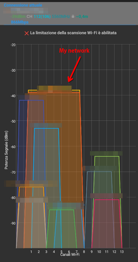

And it works! However, every client is stubbornly using 2.4ghz only, and checking the wireless spectrum i can see that my access point is being a very bad neighbor and using too much spectrum:

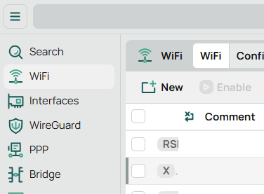

This screenshot is admittedly from a not-that-recent version, but do you not have this "New" button?
Yes, but when i press “new” it just creates a new interface, with no way to tell if it’s virtual or something else.
It's always virtual. You can clearly see this because it has a "master" setting.
Maybe it's my fault. On older versions of the wireless driver (which is not applicable to your device), it used to be called "virtual." Well, it seems it's not anymore. It's sort of pointless, because you can't really create physical interfaces, like you can't download RAM :slight_smile:
Anyway, this is the feature you should use.
