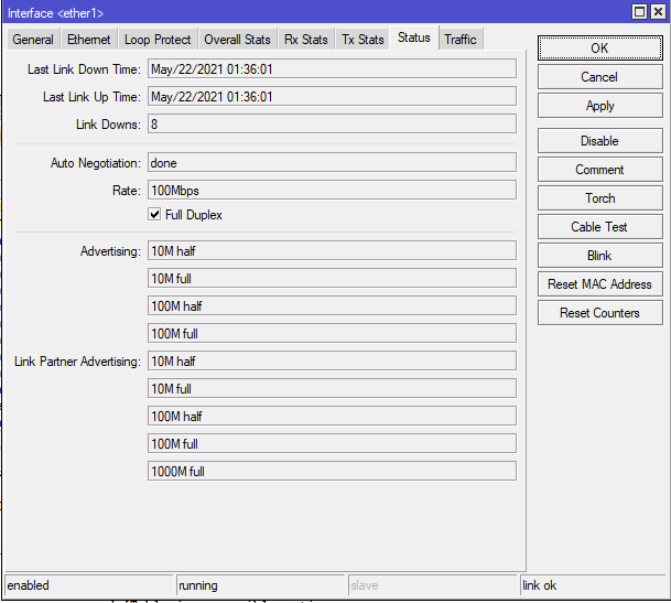

I have a RB1100AHx4 that will not advertise 1 gig full duplex. This is a wan connection and I have confirmed with the ISP they are set to auto-negotiate up to 1 gig full duplex. I am able to see the ISP advertising up to the 1 gig full duplex, but the mikrotik does not. I have confirmed that the configuration is correct for the interface. Please advise on any known issues that would cause this.
/interface ethernet> monitor
numbers: 0
;;; Circuit1
status: link-ok
auto-negotiation: done
rate: 100Mbps
full-duplex: yes
tx-flow-control: no
rx-flow-control: no
advertising: 10M-half,10M-full,100M-half,100M-full
link-partner-advertising: 10M-half,10M-full,100M-half,100M-full,1000M-full
