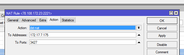

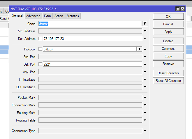

Hey guys,
The setup:
My home router with static ip: 172.17.7.175
My DVR connected to router on lease 192.168.1.101
Router is forwarding port 3427 to lease 192.168.1.101 both protocols
Mikrotik server setup:
Public IP: 78.108.172.23
DHCP Server on mikrotik is 100% working. No filter deny rules are applied BUT The dvr is not accessible outside my home with the public ip on mobile port.
What did i do wrong?
Try this:
add chain=forward dst-address=192.168.1.101 dst-port=3427 place-before=0
add action=dst-nat chain=dstnat dst-address=172.17.7.175 dst-port=3427
protocol=tcp to-addresses=192.168.1.101 to-ports=3427
That didnt work at all good sir ofcourse. The DHCP lease I talked about is in my router at home, and the mikrotik server is not aware of such lease.
so
internet - mikrotik - home router - DVR ?
on wich port does the home router listen ?
first try with the same ports; 1 on 1 mapping
