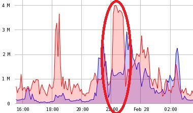

I have tried to setup total-max-limit=4M too and the error disappears. I have attached the graph last night and saw that the actual usage reached over 5Mbps which should be 4Mbps only. Apparently I missed to change the Queue type from “default-small” to “default” until now so we will see again tonight if that fixed that issue. Or if there is any other thing that we missed, anybody please assist me.
Thank you again.
Hi Skillful,
Great! Your suggestion works for me. Thank you very much.
