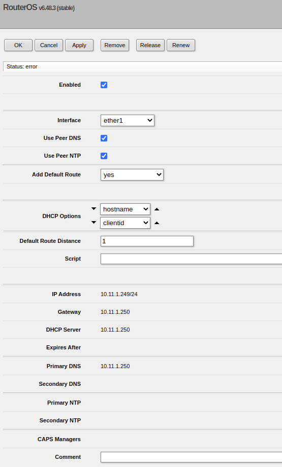

Narrowing this down a bit more… I can see that the DHCP client is in an error status, and ‘searches’ every ~ 14 seconds - which is what takes away the default route.
/ip dhcp-client export terse
# jun/13/2021 09:33:26 by RouterOS 6.48.3
# software id = 772X-DCNI
# model = RB760iGS
# serial number = ********
/ip dhcp-client add disabled=no interface=ether1
The thing that confuses me - it’s getting a lease with a DNS server and creating the default route.
/ip dhcp-client print
 #   INTERFACE                  USE-PEER-DNS ADD-DEFAULT-ROUTE STATUS        ADDRESS
 0   ether1                     yes          yes               error         10.11.1.249/24

So, why the error status?
