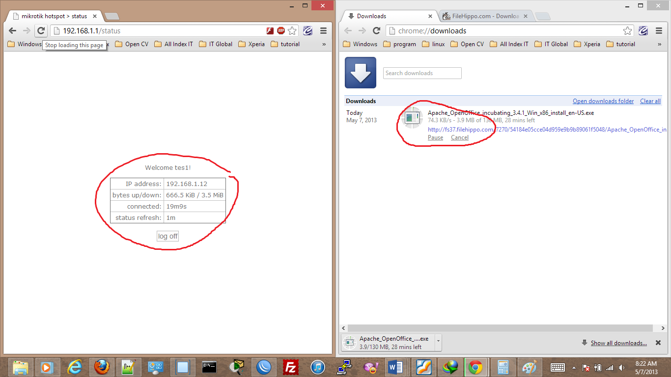

I try to test with 1 user dummy that I had prepared to download a file at a specific site using internet download manager app, but the transfer rate that I can remain in the application in accordance with the settings.
whether you think the right parameters to specify the script runs fine? how to test the script right? I need this script for my final project in college. sorry if it’s too much to ask ![]()
this is my screenshoot

I limit the quota in the number 3 mb

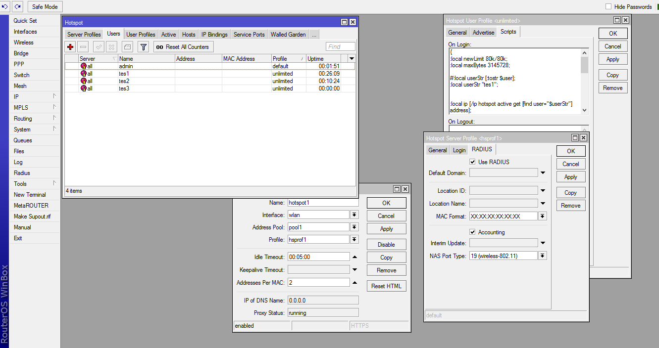

:local maxBytes 3145728;and I repeatedly tested still nothing happened ![]()
This is my setting

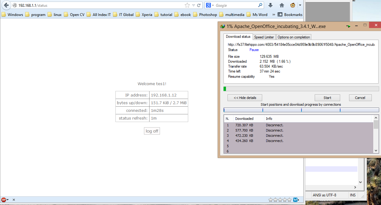

testing before passing 3 mb
testing after passing 3 mb
please help me where the settings are wrong: (
I have reset the counter at ip / hotspot reset all counters but still nothing happens: (

I do see one problem from the screenshots. The first line was changed to this:
:local slowProfile 80k/80k;From the original script, the only things you should have to change would be the values in the first two lines, not the variable names. So it would look something like this:
:local newLimit 80k/80k;
:local maxBytes 3145728;When a user logs in, if they have reached the maxBytes value, their assigned profile (under User Profiles) will change, and their Simple Queue will change. (They will not be assigned a different profile)
The way I would go about testing this is to enclose the whole script in brackets so that :local variables don’t error out. Then, change ther userStr variable to an existing User name. Now, you can copy/paste the script into a terminal window for testing. You can then use the :put command to view variable values to make sure they are doing what you want. For example, :put $bytes will show you the value of the $bytes variable. Etc.

with all due respect to you Scots, but I have follow your way back,
to make a copy / paste your script in the login box unlimited user profile, and then I reset all the counters on the simple queue and user hotspot hotspot (tes1), still nothing happens when I test downloading data fil * hippo.com site with downloadable apps default browser (goo * e ch * me).
indeed of the script that you appear not show the slightest sign of error, but after I tried to do testing, still no change, either on the download speed is obtained or at the speed indicated in the simple queue or on a log the info though.
once again I apologize for my impudence in asking. My only final year students who are studying more on mikrotik script ![]()
I attach below my settings

1 name=“unlimited” idle-timeout=none keepalive-timeout=2m status-autorefresh=1m
shared-users=5 on-login={\r\n:local newLimit 80k/80k;\r\n:local maxBytes
3145728;\r\n \r\n#:local userStr [:tostr $user];\r\n:local userStr
“tes1”;\r\n \r\n \r\n:local ip [/ip hotspot active get [find
user=“$userStr”] address];\r\n:local bytes [/ip hotspot user get [find
name=“$userStr”] bytes-out];\r\n:put $bytes;\r\n:local profile [/ip
hotspot user get [find name=“$userStr”] profile];\r\n:local rateLimit [/ip
hotspot user profile get [find name=“$userStr”] rate-limit];\r\n \r\n:if
($bytes > $maxBytes) do={\r\n :if ($rateLimit != $newLimit) do={\r\n
/log info “[DOWNLOAD LIMIT] - $userStr has exceeded $maxBytes bytes
downloaded, limiting profile to $newLimit”;\r\n /queue simple set
[find target-addresses=“$ip/32”] max-limit=$newLimit limit-
at=$newLimit;\r\n /ip hotspot user profile set [find name=“$profile”]
rate-limit=$newLimit;\r\n }\r\n}\r\nqueue simple print

total-queue=default-small07:10:04 wireless,info 20:16:D8:46:F9:35@wlan: connected
07:10:14 hotspot,info,debug tes1 (192.168.1.12): trying to log in by http-chap
07:10:14 hotspot,account,info,debug tes1 (192.168.1.12): logged in

please correct me if I’m wrong.
I was really depressed with this.thank you
