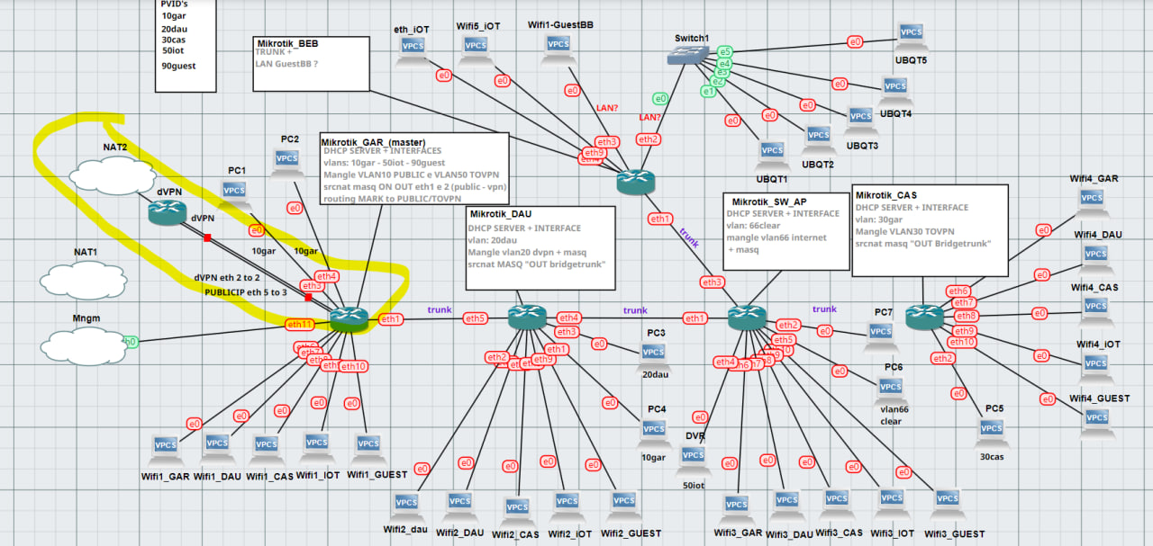

Dynamic WireGuard endpoint traffic routed outbound to a specific interface.
Small summary: I have a physical decentralized VPN device (on eth2-dvpn) between the router and the modem. It is “transparent,” and the IP on the interface is 10.10.10.3 with a gateway of 10.10.10.1.
On eth5-publicip, I have a direct link to my modem, with the IP 10.10.10.5 and gateway 10.10.10.1.
I also have a NordVPN tunnel on 10.5.0.0/24, which uses eth2-dvpn for its outbound connection.
Lastly, I use mangle rules to determine which packets should use which port.
Everything works well, but issues arise with another WireGuard tunnel. It works only if I add a static route to my smartphone’s IP, which uses eth2-dvpn. It does not work through the WireGuard NordVPN tunnel (which is the main routing table).
A strange thing happens: if I add the smartphone’s IP to the “list-dVPN-sites,” it does not work. Similarly, the NordVPN endpoint IP requires a static route, but this route never changes, while the smartphone’s IP does.
I have tried using connection marking on input and route marking (by marked connection) on output, but still no luck (refer to the first four disabled mangle rules for the attempts).
My question is how to route the outbound connection from wireguard-private (and also from wireguard-nordvpn, where the problem is less significant because the endpoint has a static IP) to eth2.
You can see both static routing rules in the main routing table, if i deactivate it, no handshake.
Here my config (Don’t worry about the firewall; I disable it during testing) and remember, i have 3 ip (public, dvpn, nordvpn), wireguard-private works if i connect to my public ip, and the router replies on the eth-2 or eth-5 (not via nordvpn)

I have a public WANIP on another modem, connected to the mikrotik via eth5 (public), and eth2 with an “hardware vpn” called dVPN (deeper network). the ip subnet from the modem to the mikrotik is 10.10.10.0/24 (.3 is on eth2-dvpn and .5 is on eth5-public). I have had it gifted, and added to the config, it act as transparent device who redirect you via a vpn tunnel to other ips.
I have too many vlans because there are 3 residential lans, plus iot, guests and a “public ip wlan”.
The wlans/vlans are shared accross all mikrotiks because in this way i have an excellent outdoor/indoor signal covering, and every group of users have their chromecasts or alexa everywhere. the cpu is still at 10-20% load, because the dhcp servers of other vlans, are on different routers, and comes from the bridge. The iot vlan is needed for common domotic.
1 and 2
Why i don’t need bridge addresses? with those address i reach other devices on the net. The setup is:
  • 10.1.1.1 (on the trunk) is the MAIN ROUTER, it has internet (2 interfaces), 5wlans/vlans, and is a dhcp server of 2vlan (50, 10) + trunk interface (vlan1 - subnet 10.1.1.0/29).
  • 10.1.1.2 (on the trunk) is the second router, it has 5wlans/vlans, dhcp server of vlan 20
  • 10.1.1.3 (always on the trunk) is the third router, always 5wlans/vlans, dhcp server of vlan 66
  • 10.1.1.4 (..trunk) 5wlans/vlans, dhcp server of vlan90
  • 10.1.1.5 (..trunk) 5 wlans/vlans
Every device has ethernet ports and virtual wifi interfaces assigned to the respective vlans ID, and if i connect to the wifi of the vlan10 from the last router, the main router gives me an address of that vlan.
If i remove dhcp or addresses (10.1.1.0/29) from the trunk, the routers do not negotiate anything.
So, the bridge ports HAS to be Tagged to make all the logic works (and it does).
3
Changed to 10.2.2.0/24
4
I need some traffic goes in vpn, other goes trough public ip. Traffic to websites or from clients.
Firewall rules for other vlans are on their respective routers, where is hosted the dhcp server. They use the main route table of the main router (gateway/dns 10.1.1.1), and exit by nordvpn tunnel, accross eth2-dvpn.
Agree with you maybe with disorganized firewall rules, i’m always a noob nerd, i will better study your words
WHY do you have IOT devices allowed to ORIGINATE traffic to vlan10
Because i can reach SOME iot devices from every vlan (a specific rule is into every router for each vlan), so i enabled communication from “devices allowed” to same devices (same list).
Maybe this clarify a bit my situation, look at the highlited static route in the main table (and also the one before it)… i wish a rule to make they use the dVPN table… the first is static so no problems, but the highlited is my smartphone ip… the wireguard-private peer endpoint :
