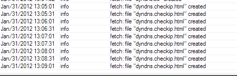

Dyndns.org script, now to remove all log info ?
I use this script, and set # on all log info’s, but this is always on log
fetch:file “dyndns.checkip.html” crated
UpdateDynDns: No dyndns pdate needed
Is no need to be on log, and i would like to remove completely log about dyndns, only successfully change may appear on log. How to change script for this ?

I know it I use this script, and set # on all log info’s, but this is always on log

you still have :log commands uncommented
Ok, now is all log commands commented, but one line in log are generated :frowning:
Is any chance to remove except that disable “info loging” in settings ?

Any other advice for script improvement to save/compare current IP address without creating html file ?
My IP is pretty stable, so that html file only gets re-written a few times a year. It’s annoying to see it, but not a huge issue for me.
Try something like this in the script to remove it:
/file remove [/file find name~"update.php.*"]
That’s a very simple match, adjust the regex to suit your needs.
i think you didnt understand original poster correctly - he removed all “:log” commands, but command “/tool fetch” produces log entry that cant be removed. so log still gets filled with those “fetch: file temp.txt created” messages.
however, i have 2 questions:
  1. does doing “/tool fetch” every 5 minutes and then writing file to flash drive of RouterBoard decrease drive’s lifetime, since it is not recommended to write to flash memories often?
  2. is there any way to get your public IP (when youre behind NAT, and cant just read it from interface) without fetching it to file first, like fetching it directly into variable?
thank you very much for your time
Preventing the fetch from creating a log entry would be something that needs to be changed in the source. I don’t think there’s anything you can do in the script to prevent it.

Hi all, first of all sorry for my bad english, I’m Brazilian.
So, reading the DNS-O-Matic API - (https://dnsomatic.com/wiki/api) - Documentation says: For clients using OpenDNS, a DNS request for myip.opendns.com will always return the public IP of the client.
And I tried:
:global currentIP [:resolve myip.opendns.com server=208.67.222.222];
Worked great! No more logs with fetch file…
Work for NAT too!

This is only to remove fetch file at log, if you would like no log at all, remove all :log comment’s at code.
