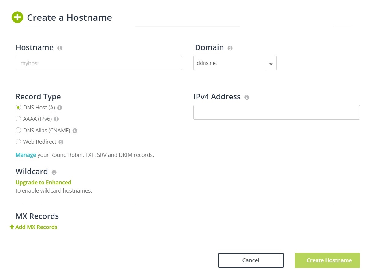

I do use noip.com. There you can use DNS Alias. But I do not see how to change a currently registered DNS to use DNS alias, but for new site you can do. Look at attached picture.
