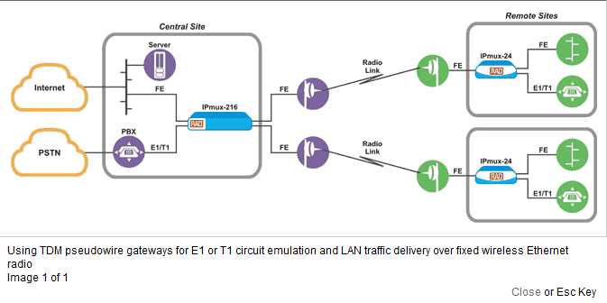

See the below link from RAD. This product is for use with generic Ethernet radios. All of the traffic priority control is done withing the MUX and not the radio.
http://www.rad.com/14/E1-T1-Circuit-Emulation-and-LAN-over-Fixed-Wireless-Ethernet-Radio/4272/#
is that the reason RAD or Ceragon use an ODU and IDU in combinations?? while with Mikrotik we only use the ODU ??
From what I understand you put both your LAN traffic and E1/T1 traffic thru there mux. This allows them to prioritize T1 traffic over the LAN traffic.
