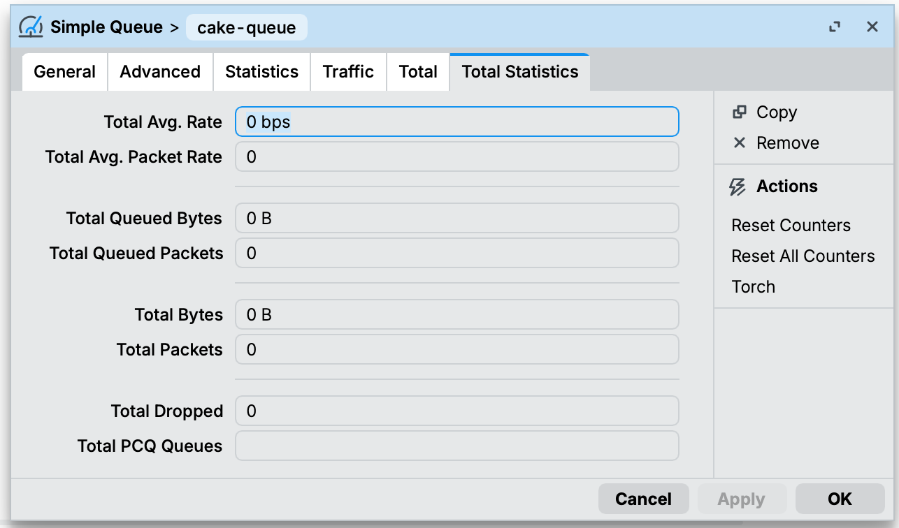

However, now the entire traffic is no longer displayed under the Fasttrack rule. The Queue Simple Total counter also remains at 0, for whatever reason. Is there a possibility of a dummy rule that counts the entire traffic for me?
Then your simple queue is maybe not working?

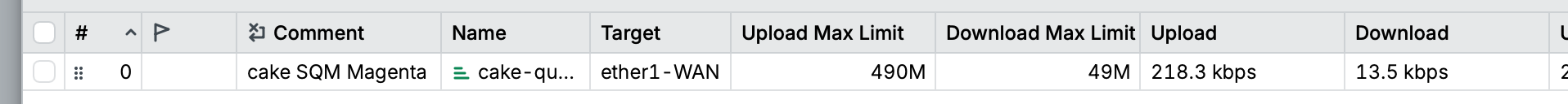

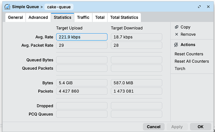

I think so, the queue is “green”:

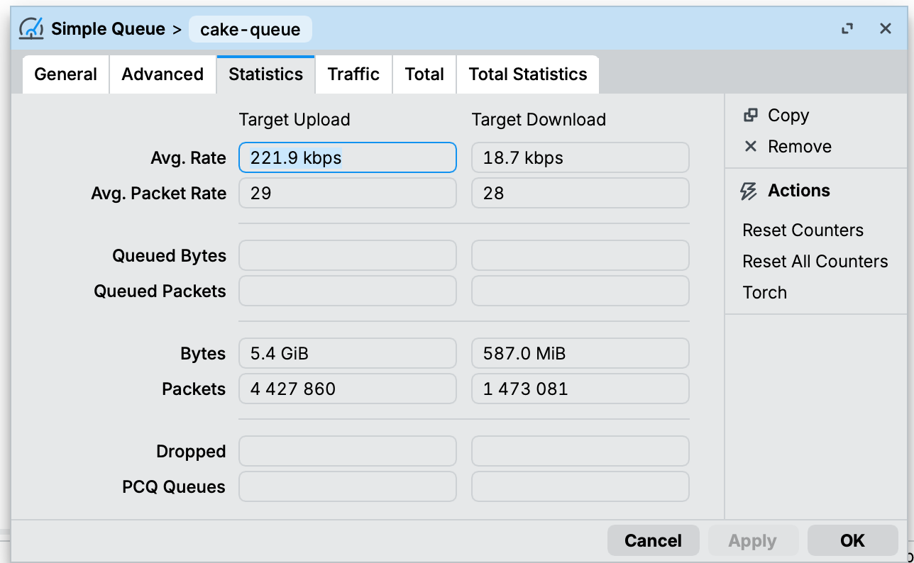

And here is traffic also:
But here is everything “0”:
The result of the waveform test is now perfect, so something is “happening” :wink:

a found it, had to set
/queue simple set “cake-queue” total-queue=default
value was “default-small”
Back to my question, can I now see the total traffic with a dummy rule somewhere?
You can see it already at the "Statistics" Tab. I don't know what else you are looking for

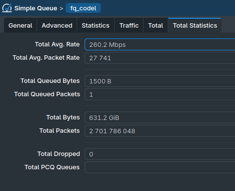

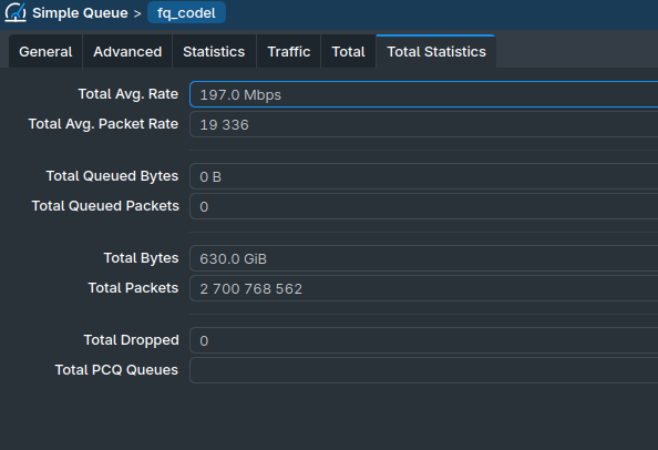

You should see the total, I have a simple fq_codel setup on ax2 some of the stats will only show when the queue is busy, first graph no load second loaded.
Of course, now I can see everything in the stats, sorry, I was on the line just now :wink::see_no_evil_monkey:

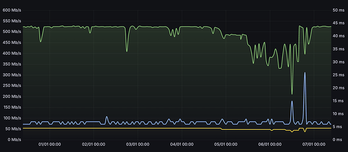

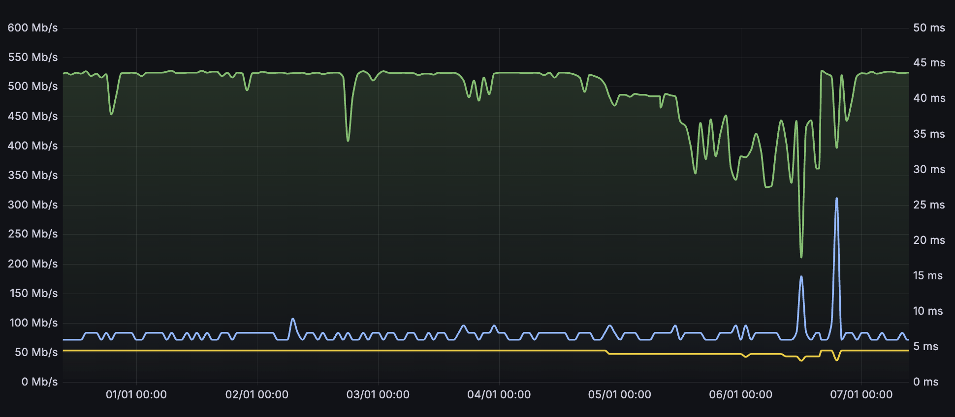

One more question about the CAKE queue. The graph clearly shows when CAKE was activated. I measure at regular intervals with Speedtest CLI. Before and after that, I have consistent measurements. During the test phase when CAKE was active, the values fluctuated extremely. Is that normal?
green: download, yellow: upload, blue: ping
Please add a legend for green, blue and yellow line. thx.
