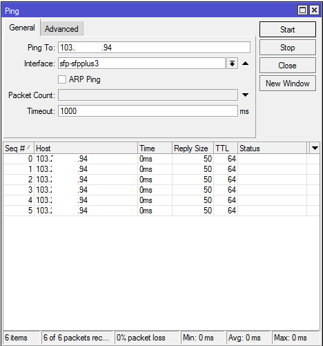

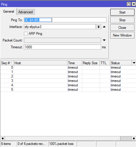

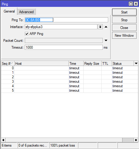

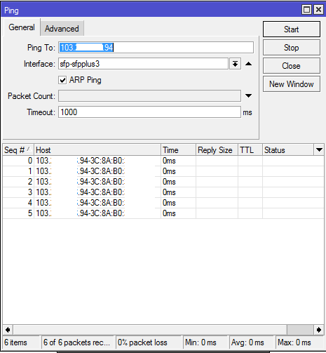

I am able to ICMP ping the 103.xxx.xxx.94 gateway fine. I am able to ARP ping the 103.xxx.xxx.94 gateway fine. I am NOT able to MAC Ping the 3C:8A:B0:xx:xx:xx gateway. I am NOT able to MAC ARP ping the 3C:8A:B0:xx:xx:xx gateway.
