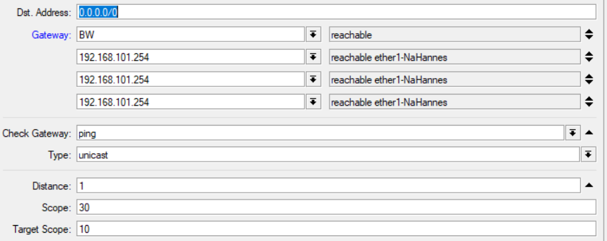

I am having a problem with ECMP routing since 6.41…
I fill in the information, as used successfully before like this:

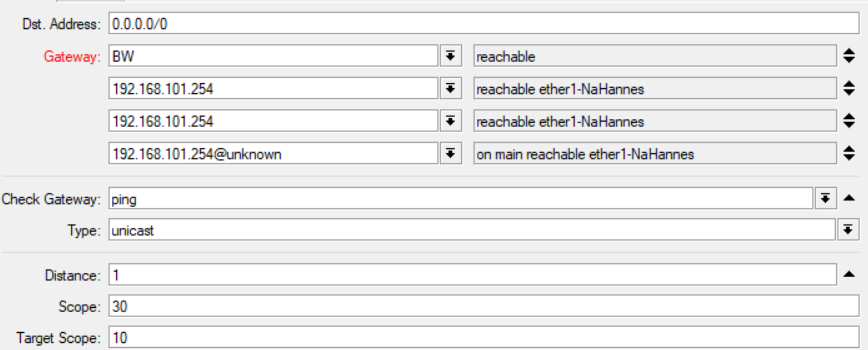

When I click Apply, this happens:

What is BW? If it is not a point-to -point interface then setup is invalid. Another problem you have is check gateway ping is not going to work on ECMP routes.

Apologies for being unclear: “BW” is a PPPoE connection, and that is functioning, the problem is that “@unkown” that is automatically added when I press Apply…
Looking at https://wiki.mikrotik.com/wiki/ECMP_load_balancing_with_masquerade it is suggested to use Check gateway: Ping - What should I rather use then?
