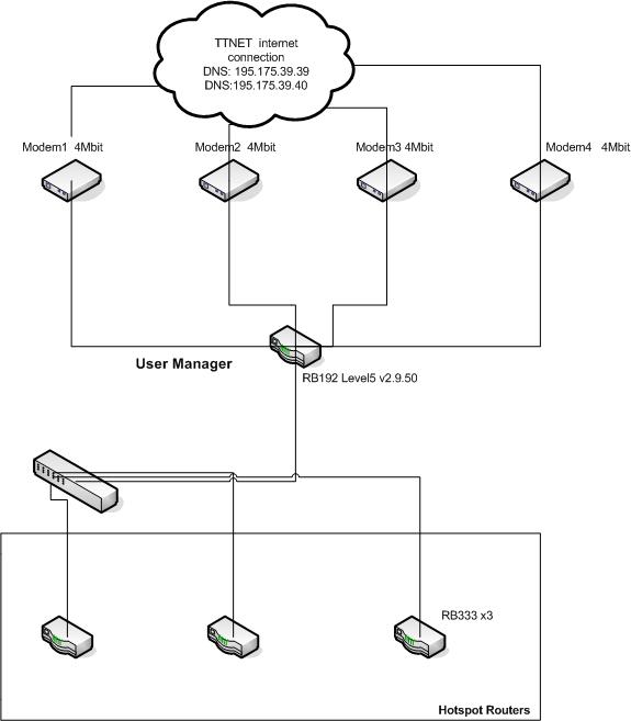

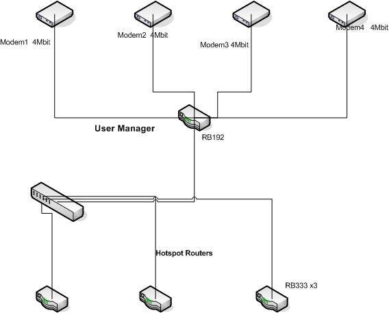

Picture show abow
Router RB192 checks the modems modems are power up but one of them not connect to internet,
How can i find which modem dosnt connect internet, after that close that modem connection fot http(80)
how can i write script to test modem internet connections

So just to get this straight … the default gateways you are using are on your network, or are they across the internet at your ISP?
If you use check-gateway it simply pings the gateway, and if its unreachable it will disable the route automatically… however, if that gateway is ALWAYS up because its inside of your network then you will need extra scripting.
If your gateways are local check-gateway wont do what you need. If thats the case let us know and maybe we can code something up for you real quick.
SRY about my english or explanation methot
i make a picture, tell the config,
