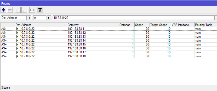

And for "science" here is the test, but with 8 distinct gateway addresses:
add dst-address=10.7.8.0/22 gateway=192.168.88.11
add dst-address=10.7.8.0/22 gateway=192.168.88.12
add dst-address=10.7.8.0/22 gateway=192.168.88.13
add dst-address=10.7.8.0/22 gateway=192.168.88.14
add dst-address=10.7.8.0/22 gateway=192.168.88.15
add dst-address=10.7.8.0/22 gateway=192.168.88.16
add dst-address=10.7.8.0/22 gateway=192.168.88.17
add dst-address=10.7.8.0/22 gateway=192.168.88.18
Output from the script above:
192.168.88.11=108;192.168.88.12=129;192.168.88.13=129;192.168.88.14=133;192.168.88.15=138;192.168.88.16=133;192.168.88.17=112;192.168.88.18=134
With 8 possible gateways, the perfect distribution is 1016 ÷ 8 = 127 per next hop. And the result is pretty close (it depends on the hashing algorithm)

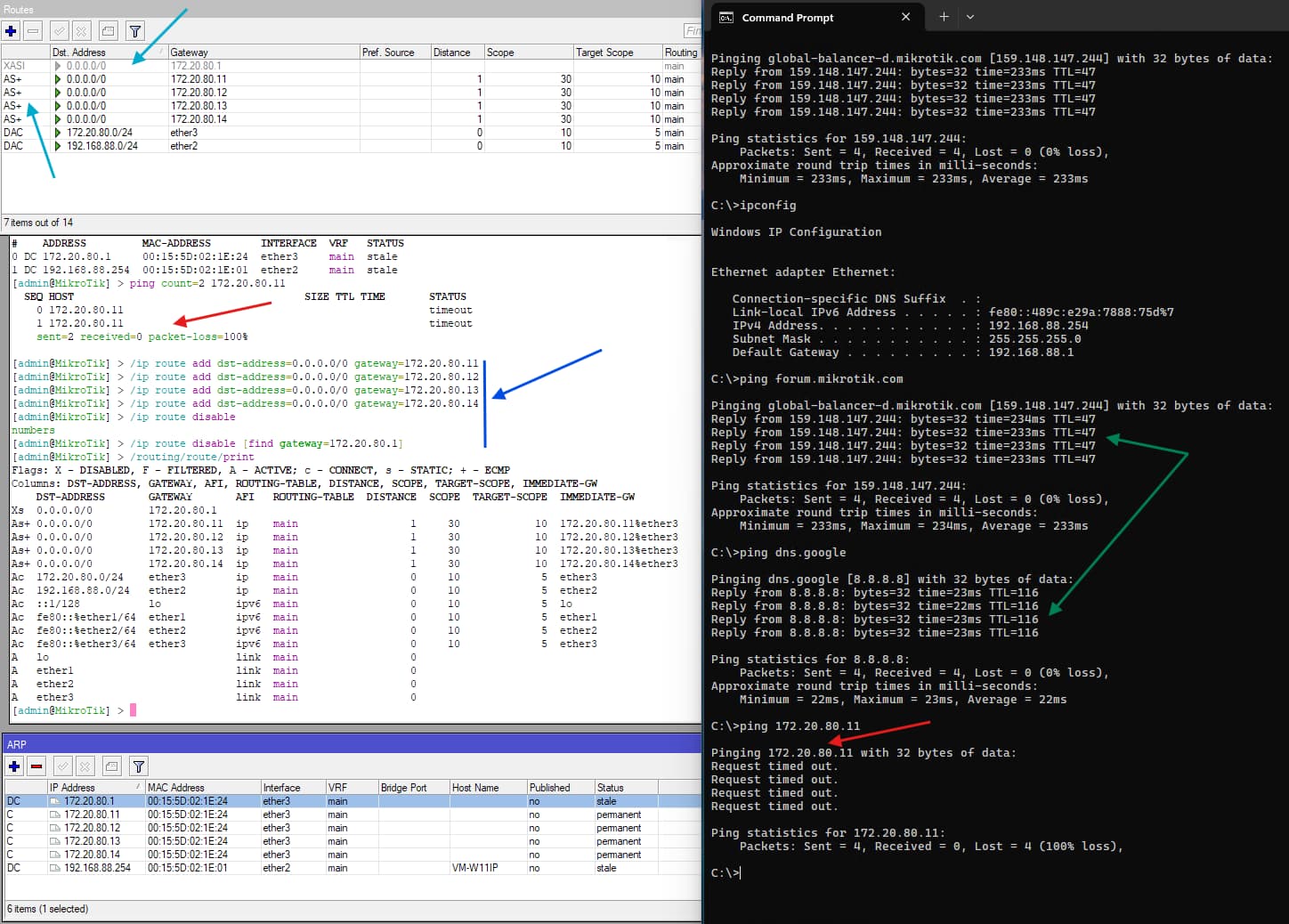

It does work, here is some test setup I just did:
Router is CHR with minimal config. ether1 currently has DHCP client disabled and does not participate in the test. ether3 is WAN with 172.20.80.1 is the real gateway. Standard DHCP server is setup on ether2 with 192.168.88.1/24. Windows VM is connected to this and get IP address and has internet access (can ping forum.mikrotik.com).
As you can see, the host 172.20.80.11 doesn't exist (nothing answers ping).
Next the the ARP-copies trick is performed. ARP entries for 172.20.80.11-.14 are added. The default route with gateway=172.20.80.1 is disabled, and the 4 ECMP routes to the bogus gateway addresses are added instead.
In this screenshot you can see that the Windows VM has full internet connectivity, although it can't ping 172.20.80.11 (non existant host). The 4 routes are present in the routing table as ECMP routes.
The test with the script from the above post shows "equal" distribution among the 4 next-hops:

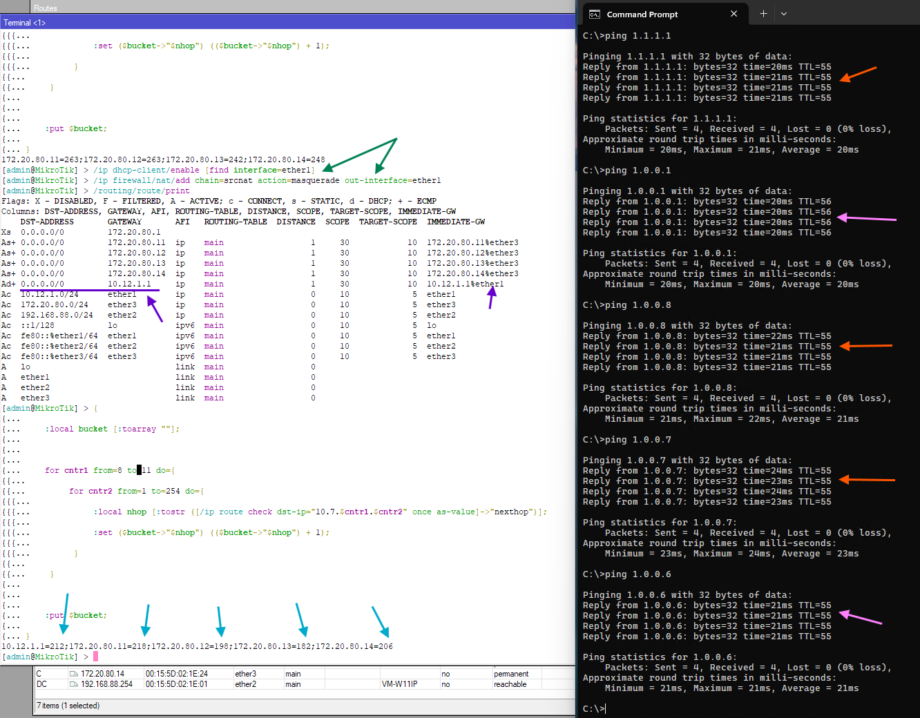

Next I enable DHCP client on ether1 and add a masquerade rule. This add another really different default route to the router (gateway 10.1.12.1 on ether1):
Ping test shows that depending on the destination, sometime you get TTL=55 (the ether3 route), sometime TTL=56 (the ether1 route).
And the test from the script above shows the distribution of the 1016 destinations across the 5 possible next-hops.
