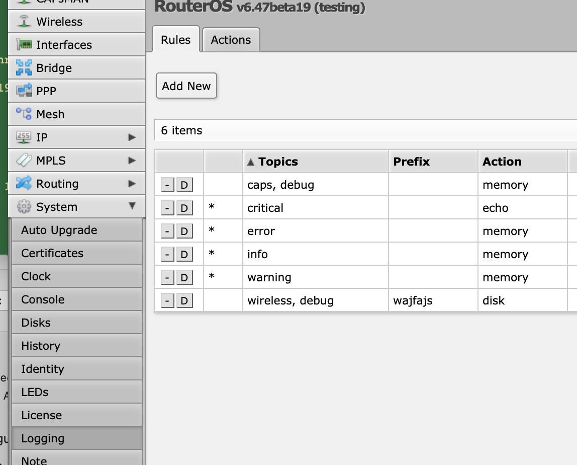

please add the LTE logging topic and disable/enable the LTE interface and check the log why it isn’t connecting.
Hi

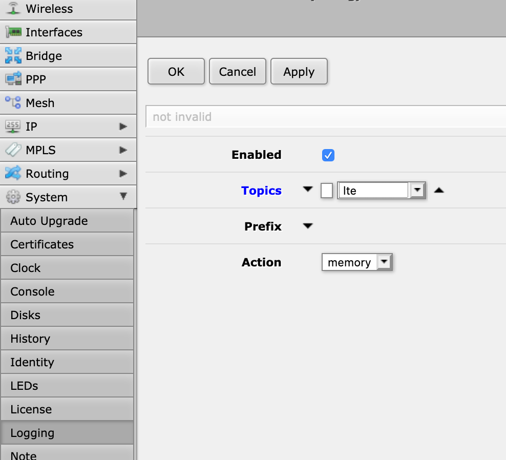

What do you mean add the LTE logging topic? I have disabled and re enabled but has made no difference it doesnt say anything in the log about LTE!
Got the LTE logging topic
Go to the System Logging section and add new entry with topic LTE.
Like this

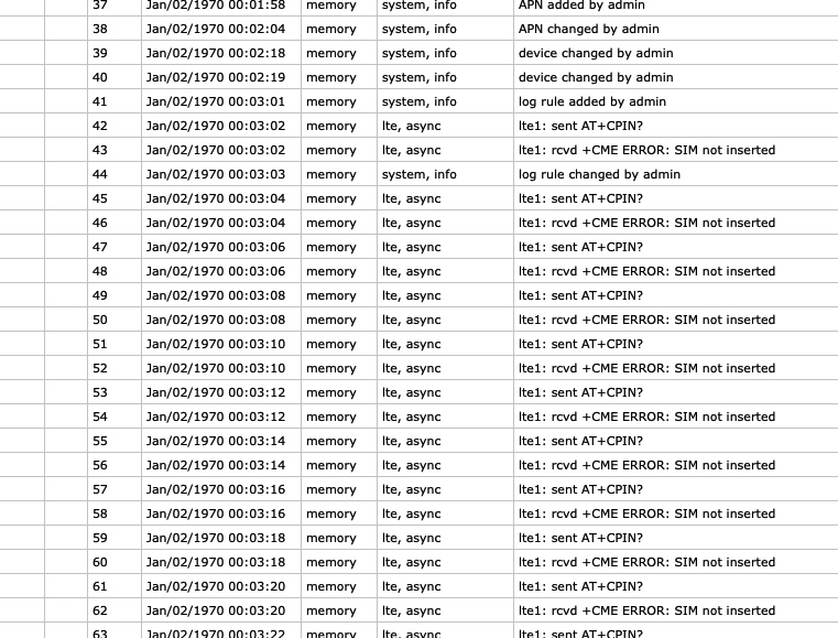

Hi here is the log
Well, SIM is not inserted, dirty, upside down or something like that.

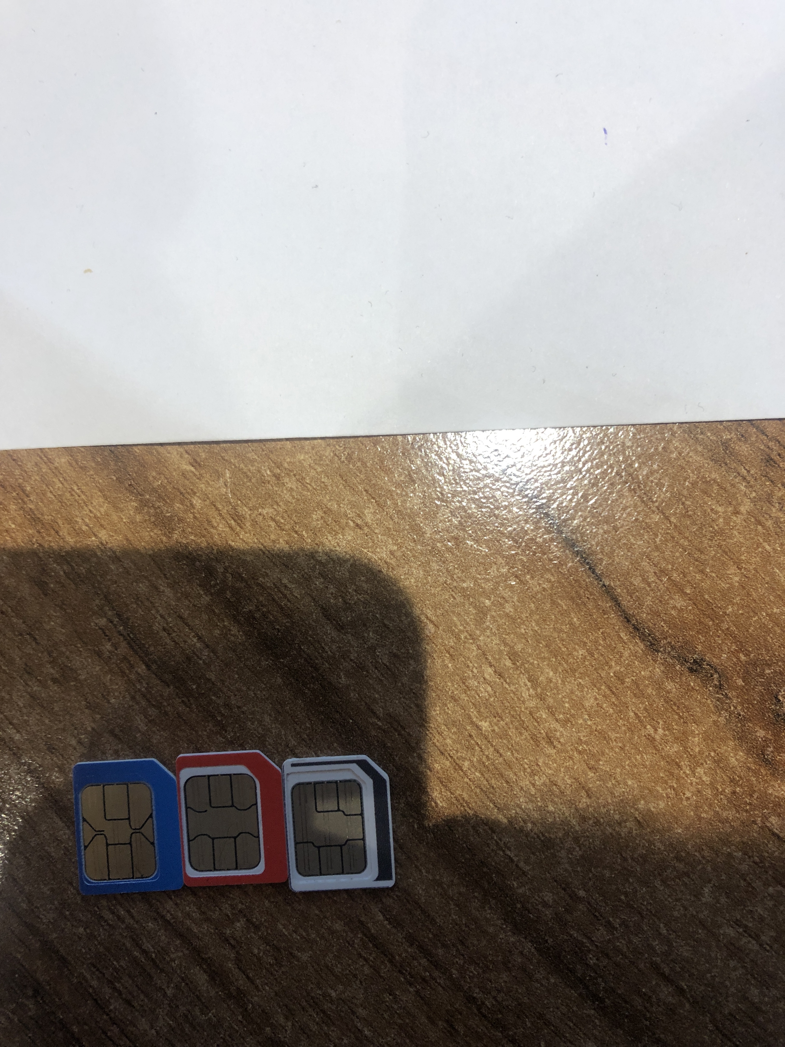

SIM is 100% in correct and works in another device that has custom software (SIM RUSH) also o2 sim works ok in device and so does vodafone
How about other SIM in this device with SAME orientation as current one?
Modem doesn’t see the SIM, that’s all I can say.
Other Sim works fine and inserts the same way what I would say is the chip on the sim is slightly different here are all 3 sims from left to right is o2 then Vodafone then EE like I said the sim works fine when it is in the exact same model but it has custom software on it
Sorry bottom to top is o2 then vodafone then ee
I cant get in to the one that has custom software as I dont have the admin password and they have disabled all the features except the APN list
Does anybody else on this forum have an SXT working with an EE sim
So you probably mean the UK operator EE.
Still, the SIM is not being detected. Maybe the thickness is different?
Try some sticky tape under it maybe. The newer SXT LTE model has two slots. Also try another SIM slot. Then you will have to adjust the used slot in the RouterOS settings.
