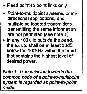

Depends. When your regulator allows Eirp per device yes. When it is
allowed per place you’ve the same restrictions.
EDIT: See attached regulations
Does muiltiple co-located transmitters include a MIMO link?
