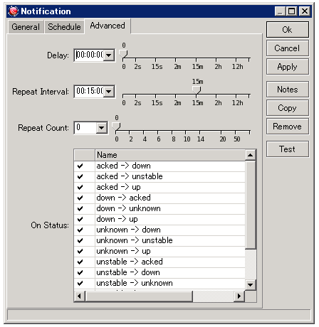

hi
did you find this?
with these settings i get just about the right number of notifications for my environment
good luck!
