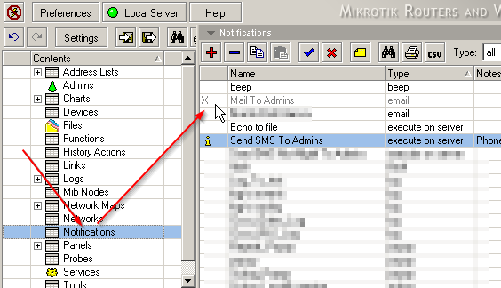

You should check if notification is enabled on the notifications tab
No it isn’t, but isn’t that showing the setting from the top level in settings > polling if you wanted to set all object to use notifications by default?
If it’s unticked you then set at the lower level for each object you want notification for.
My issue was that it was working and then stopped after the server was rebooted, when I then went back into Dude, none of the objects have notifications setup
