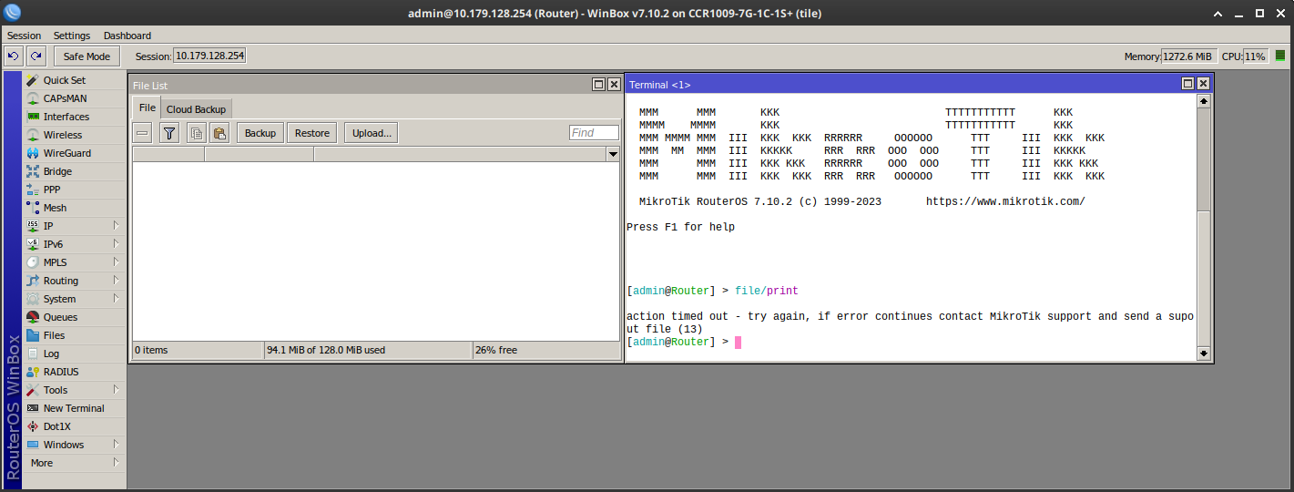

I have upgraded my router CCR1009-7G-1C-1S+ from firmware 7.9 to 7.10.2.
When I use WinBox and try to list the files on the device I get nothing listed. There should be some files on it because they were listed with firmware 7.9.
When I use the command prompt, I get a timeout on “file/print”. See at the screenshot “mikrotik.png”.
Also, when I look at the file statistic in WinBox (screenshot), I have 26% free space and about 94MByte of 128 MByte is used.
What can I do to list and access my files?
thx in advance,
Phil

I have found the issue. I was using an SD card to expand my storage. It turns out that the card is damaged. I removed the card from the back of the device and rebooted it. After that I was able to list and access the files through Winbox and the console.
