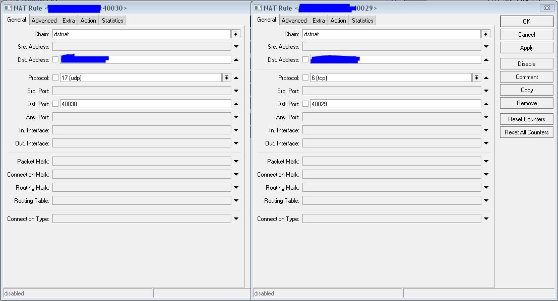

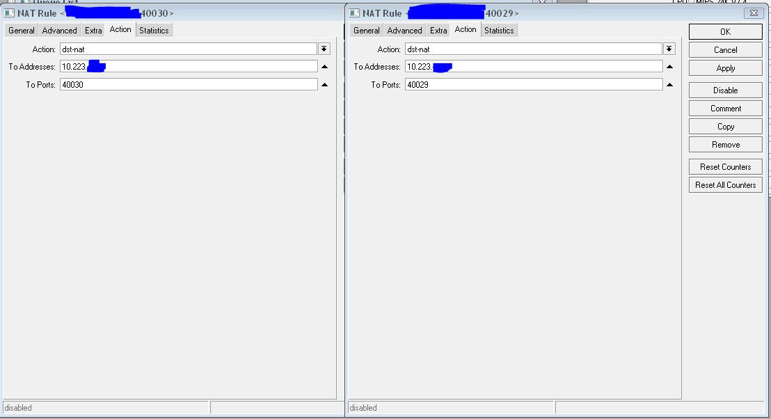

Here are the pictures. Are the ports forwarded correctly? IMHO, they are.

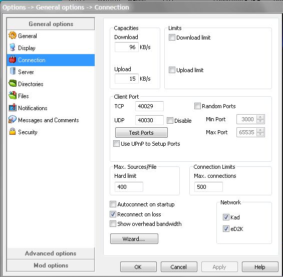

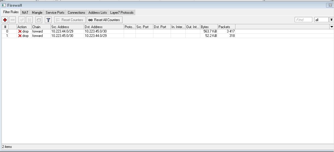

And the last picture:

Router doesn’t drop anything just for fun. But it could do it, if you had some other firewall rules that could influence it, e.g. some attempts to secure the network. Do you have anything like that? Or is it just two rules for eMule and one for NAT?
In NAT I have some forwardings for various ports, and in Filter rules I have 2 rules to isolate the PCs that are behind the router. I’ve NAT-ed them with their own network.
Any Ideas what could cause this behaviour since I haven’t used filters?
disable all those rules and try then
I did, but I still get few results.
