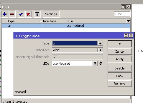

You can already do that, example:
/system leds
add leds=user-led:red type=on
add leds=user-led:blue type=off
This makes the LED pure red color.

Still working for me. What is your error?
If you don’t see any LEDs in the droplist, post your Audience serial number and I will investigate more

Looks like in newer revisions the LED is no longer software controlable, as it’s made differently now, with hardware assigned functions. Sorry, no longer adjustable.
