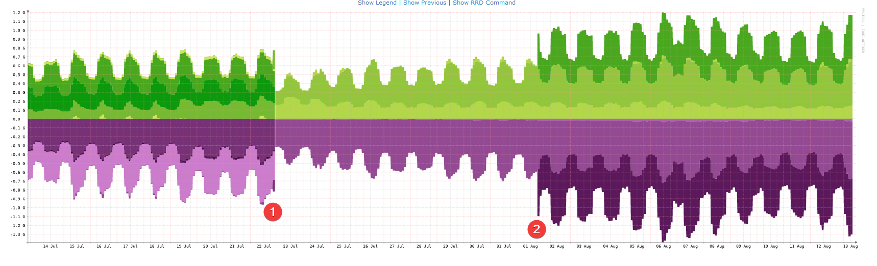

As I enable the switch chip for vlan/bridge offloading.. the bandwidth all starts doing this..
Fourth unit out of ten..
CPU doesn’t seem to drop, latency isn’t increased or decreased..
Not sure where the hardware/switch chip/vlan/bridge offloading benefit is..
Suggestions?

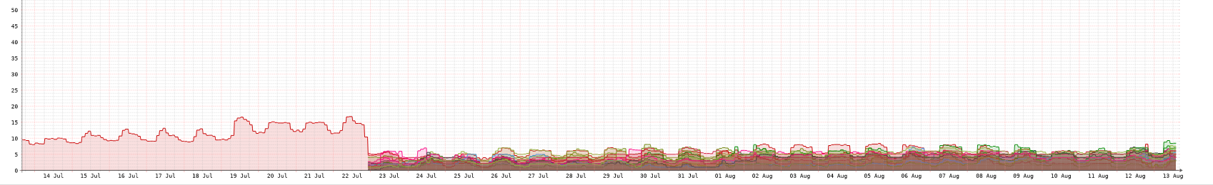

Image hsJyq.. point 1 is moving to the Mikrotik 2116, and point 2 is enabling switch chip/vlan/bridge/etc
Imae sj9QB.. is the cpu for the same time.. the change is the replacement of the 2116 and all of its many cores/threads..
