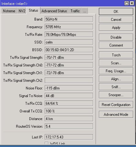

I upgraded to 5.4. Currently I have HT-MCS set to 12 and have 78Mb. I have set it to 15 and got 130. I am wondering about the stats on the attached jpeg. How is it I have 100%CCQ, but TX/RX CCQ 65/64. Is this acceptable or do I need to make some changes to improve things?
