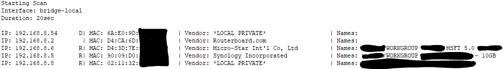

Enhanced IP Scan with Vendor and Additional Name Sources
I often find myself wanting more from the standard IP-Scan tool.
This script will perform a normal IP-Scan then augment it with vendor names pulled from api.maclookup.app.
(The script is rate limited to not exceed the API limits, you can register for a free API key if you want to go faster and remove the :delay.)
In addition to the normal DNS, SNMP and Netbios name detection, it will also scrape names from the Neighbours table as well as Hostname, ClassID and Comment from the DHCP leases table.
Updated 16-10-24 - Now sorts results, in as efficient a manor as I could manage. :laughing:
Updated 17-10-24 - Now also lists interface matched from the ARP table. This is especially useful when you’re scanning a bridge with multiple VLANs on it.
Updated 25-10-24 - Updated to selectively send additional octets to maclookup api for unusual vendors using larger mac address blocks.
Updated 10-11-24 - Now supports optional API key use - Free registration here (I have no affiliation): https://my.maclookup.app/login
Tested down to ROS 7.10. Requires v7 minimum.
You should modify “scanInterface” and “scanDuration” to suit your network.
Add as a script named “ip-scan-vendor” then run from the CLI with:
/system/script/run ip-scan-vendor
Last Update 17-02-25
Small bug fixes on arp matching.

EDIT: This post is still valid but is referred to first version of the OP.
I see “on the fly” two big mistakes:
the first is that the entire mac-address is sent to the site (uselessly), instead of just the vendor part, screwing up privacy,
the second is that the invented/random or local-use mac-addresses are also requested (bit 2 and 1 of the first byte),
which are a waste of resources for those who host the service for free.
then I see a lack of coherence in variable names (example scanInterface, scanDuration, scanresult),
and also a fundamental lack of “/” where it is needed (example [tool and [ip )
excess of . and " where it is not needed (for example :put ("IP: “.$address.”\t | MAC: ".$mac[…] must be like :put "IP: $address\t | MAC: $mac[…] )
and I’ll stop here.
Ahh rextended, always a pleasure.
Good point about the mac addresses, I’ll give that some thought, thank you.
Don’t suppose you could lend some of your expertise to my question about sorting multidimensional arrays in Mikrotik script?
Perhaps an example that would work in my script and allow me to sort by IP?
Grazie mille bello :smiley:
Updated 15-10-24
Modified above to include rextended’s suggestions as well as those of a colleague.
Script now only sends required octets to api.
Random MAC addresses are shown as LOCAL PRIVATE. https://www.oasys.net/fragments/identify-private-macs/
Added a flag for DHCP state.
Added the ability to save a logfile.
General tidying up and remembering how to write a function in Mikrotik script. :smiley:
Looks a bit like this:
Very useful your script, thank you!
BR.
Thanks for letting me know you found it useful!
Though I’d much rather Mikrotik would add this kind of metadata to the regular scan function. Preferably with the vendor data but even just the DHCP and Neighbours table info that’s already present in the system would be very welcome.
Updated 16-10-24
Code above is updated, now sorts by IP address!
I’m sure my sorting method is horrific, please do chime in if you can tidy it up / make 1000% better by re-writing it.

Hi!
@excession could you please help me?
In the following code snippet, it does not work when the MAC address does not exist in the Bridge Host table, it gives me an empty result, I should see NOT AVAILABLE.
If the MAC address does exist it reports your interface correctly.
Where is the error?
Thanks.

Might be better to start a new thread to work on your scripts, but in the interest of good spirit.
Looks like your “else” is on the wrong “if” statement, seems to me you could remove the else entirely and do something like this:
:local iFace "*NOT AVAILABLE*"
:local macAddress "54:B7:BD:70:0F:B8" ; # Does not exist in the bridge host table
# :local macAddress "E0:CC:F8:E7:90:4A" ; # Yes, it does exist
:local bridHost [/interface/bridge/host/print as-value]
:foreach i in=$bridHost do={
    :if ( ($macAddress = ($i->"mac-address") ) and ([:len ($i->"on-interface")] > 0) ) do={
        :set iFace ($i->"on-interface")
:put $iFace
It works correctly, thank you.
