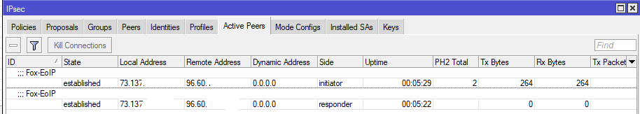

EoIP and Bridge Connection
Router: RouterBOARD 3011UiAS
Firmware: 6.48.4
Summary:
  • Created successful EoIP connections
  • Set MTU to 1500
  • Created Bridge
  • Added EoIP tunnel to Bridge
Problem:
The Bridge Port for the EoIP Tunnel is “disabled port”
Why can I not enable the Fox-EoIP Bridge port? Without that I cannot connect the two routers to share the same LAN.
Thank you
It would be great if you post your configs here.
/export hide-sensitive file=r1

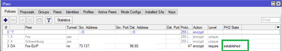

Your screens show IPSec stablished… but we can’t see EoIP configuration or state. Please, post your config if you want help
I found the issue was with one of my firewall rules I had configured to drop connections already not established. I thought the EoIP connection would be considered an established connection and not be impacted by the drop rule below:
