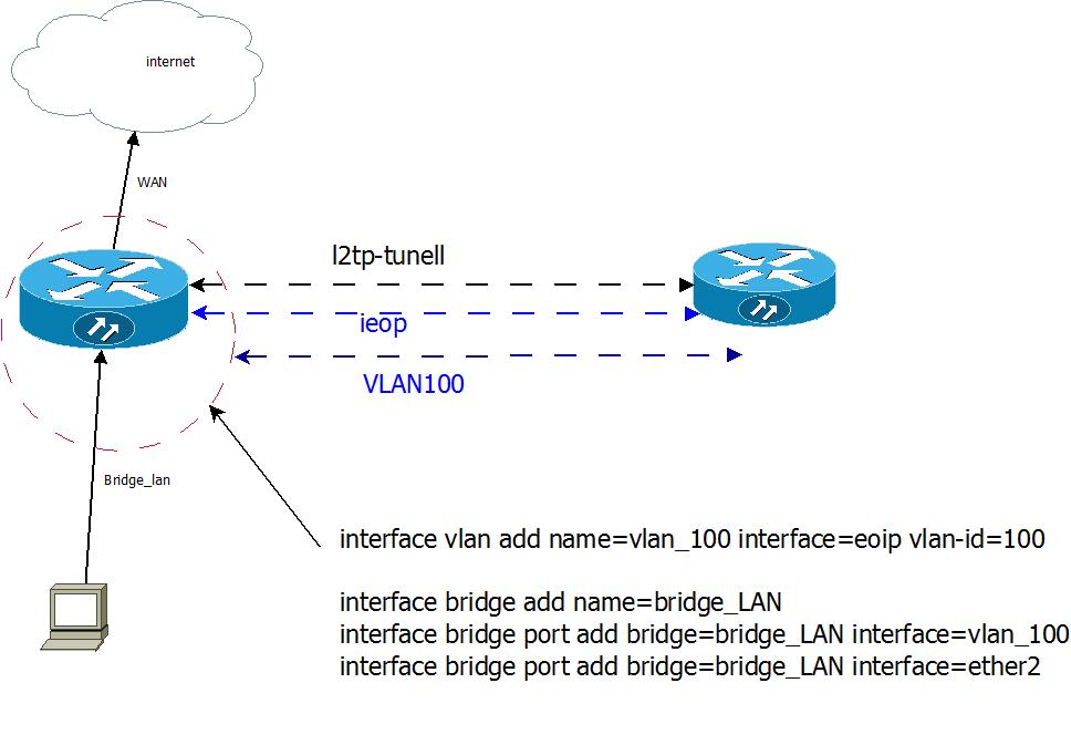

Now, a week ago the same thing occurred again, while I was on vacation and colleagues moved EoIP from one mikrotik to another, but I’ve checked and everything was fine. Suddenly users report that several sites are unavailable. Finally the reason is found - same EoIP in local bridge problem. So I had an advice from MTCNA to remove EoIP interface from the bridge, make a VLAN with EoIP as parent and include VLAN into bridge. Now everything works fine, but all this schema looks like crutches to me. Should it be like that? Maybe there is a way to make it better?

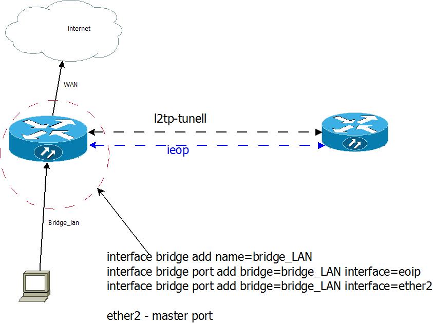

The whole idea using EoIP is to get a remote LAN segment available on layer 2. Also EoIP goes over L2TP which is encrypted with IPSec. L2TP MTU is 1400, EoIP MTU is 1358.
I’ll add schemas to the story above.
In this mode, some sites were not opened
This all is well
VLAN hasn’t solved the problem, so I guess its pointless. But I found a ticket history from a year ago with Martins and I remembered that it was all about bridge MTU after all. So now I’ll check it again.
