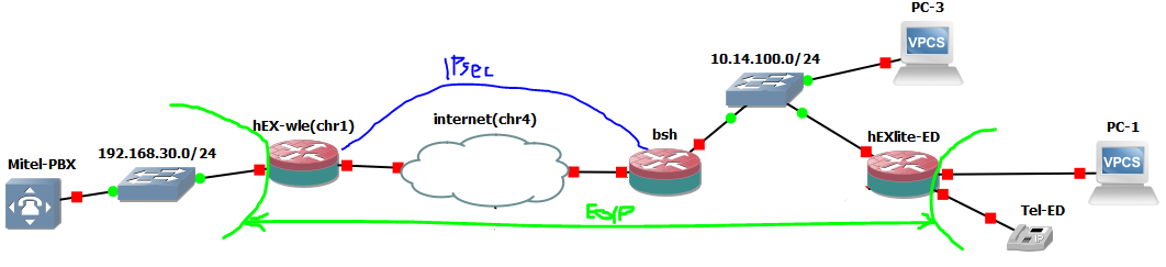

I need to bridge two networks together and I think EoIP is the easiest way to do so - MPLS would be much more complicated. In the GNS3 lab the EoIP configuration worked great, but on the production system one side of the tunnel doesn’t receive packets. The other side can send and receive.

This is the (simplified, but very close to production) setup that works in GNS3:
Any idea goes wrong with the main side, not receiving any packets?
