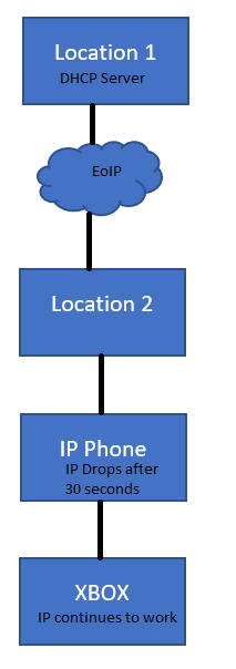

Details:
  • Established EoIP connection
  • DHCP Server on location 1
  • IP Phone on location 2
  • XBOX on location 2
Summary:
  • The XBOX is connected to the IP Phone via ethernet
  • The IP Phone and XBOX will receive an IP from location 1
  • The XBOX will maintain the IP address from location 1
  • The IP Phone will drop the IP address 30 seconds after it receives it
  • The IP Phone will keep the DNS settings, not the IP address
  • I can Ping the XBOX from location 1, through the phone
Question:
Why am I losing the IP address on the phone? I tried with 2 different phones. One that I used before, and a new one I just bought to test with because of this issue.
