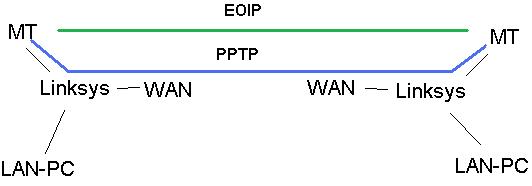

Please draw us a picture of your setup and differentiate between wired and wireless links and upload it…
There are no wireless components on this network. Thanks.

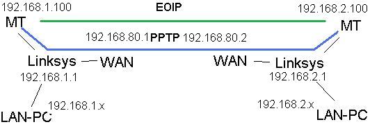

Please post ip ranges that are have configured…
Can you connect the lan PC’s directly into the Mikrotik and bypass the linksys?
I would like to keep the network setup as it is, as I am trying to keep my impact on the existing infrastructure to a minimum. I have setup my routes as 192.168.2.x to 192.168.80.1 and vice versa. Linksys is DHCP server on both networks. I have my client PCs setup with MT as gateway, and a route on the MT 0.0.0.0 > linksys.
