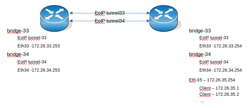

I have two mikrotik routers in diferent locations with multiple networks, some of then connected via EoIP tunnel, look this basic network scheme
The EoIP tunnels are working fine, I can ping machines between networks 172.26.33.0/24 and 172.26.34.0/24, machines in network 172.26.34.0/24 can also ping machines in network 172.26.33.0/24, including the gateways in both ends. Client machines in network 172.26.35.0/24 can ping machines in 172.26.33.0/24 and 172.26.34.0/24, also, they can ping the gateways in is network location (172.26.33.254 and 172.26.34.254) but the can’t ping 172.26.33.253 and 172.26.34.253.
Machines in networks 172.26.33.0/24 and 172.26.34.0/24 are servers and our goal is translate the servers in the more transparent way to the new location. After the servers are moved we are going to change the gateways in both mikrotiks (172.26.33.253 would become 172.26.33.254 and vice versa.), but in our tests, after change the gateways, the clients can’t connect to any machine in 172.26.33.0/24 and 172.26.34.0/24.
I have inspected the icmp traffic with torch on both routers, when a client ping 172.26.33.253 I see those packets arrive at the remote location, and, in the main location I see the response monitoring the bridge interface, but this response does not reach the client.
In firewall filter I have a rule to allow traffic from the Bridge to ether35. I don’t know whats wrong, any help is appreciated.
You’re asking about problem with your routing but you don’t provide the setup you have (and serms to have an error in it)?
sorry for the delay, after reviewing the configuration I found some bugs which, after being corrected, solved the problem. Now, I have another issue, I have done some speedtest using iperf and I have a very poor performance across the tunnel.
