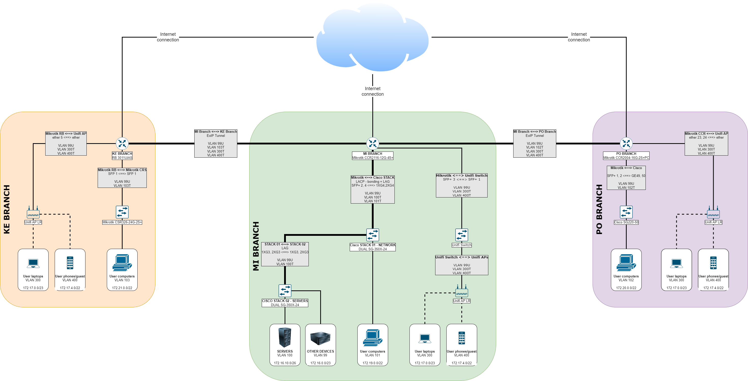

this is our current network configuration:
