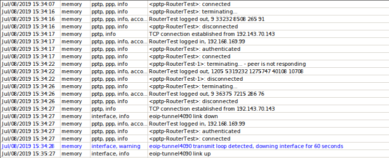

When the primary LTE link fails, both the PPTP tunnel and the EOIP tunnel fails over as expected and rebuilds across the secondary link. A new PPTP tunnel is built and the ‘old’ tunnel is torn down almost immediately.
The issue:
Once the Primary link restores. A new PPTP tunnel is ‘rightfully’ built, while the ‘secondary’ PPTP tunnel remains connected on the core side and service works for a little while. Once the ‘secondary tunnel’ times out and the 'new tunnel built, a loop error is detected and the interface ‘downed’. Understandably this loop prevention is valid, however, using a single PPTP tunnel across different providers to the same CPE, we will never run into a situation with loops and must disable this.

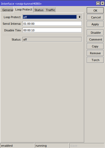

We’ve tried disabling the EOIP Loop prevention altogether with no effect. Playing with the timers (Send interval and Disable time), however, the issue remains; interface down for 60 seconds). This has an impact on our client service as restoration can take up to 2 minutes to restore, which is not ideal for our client experience.

  • Are there other ways of disabling the loop prevention we might be missing, if so, where and how(I am thinking the parent interface)?
