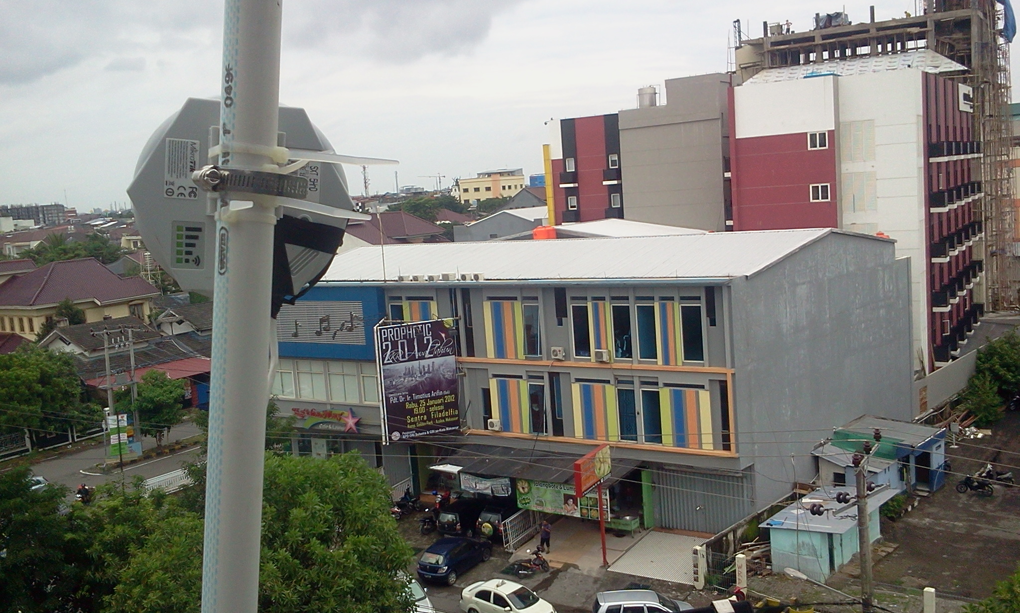

by the way. i have this client, currently on point-to-point 2 nanostation M5 facing each-other. when i use the nanostation from client to do site survey, it seems the signal from omnitik a lot lower than the nanostation AP gives. the omnitik is placed about 20cm higher from the nanostation AP on the same pole. i get signal strength -77dBm from the nanostation AP, and -85dBm from the omnitik. is this normal? or maybe i missed some settings on the omnitik? Tx Power Mode is set to Card rates and 26dBm, i believe that is the maximum it could transmit?
thanks again
the SXT is running well and connected to an OMNITIK AP with great result because of short distance :laughing:
i’m still curious about the nanostation M5 signal though.
NSM5 has a higher gain antenna than OmniTik, NS has a directional antenna, while OmniTik has an omni (hence the name).
