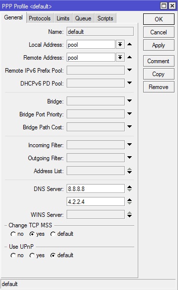

I hope new images will help you, Settings updated.
I can connect only in server (image 4) , tried different ways but I didn’t succeed involved in about 10 days …
can i give you information for check …
Try disabling CHAP and only leave mschap2 and mschap1 active.
You can get more detailed logs when adding pptp to /system logging
-Chris
It got but again don’t working
