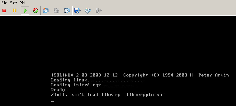

I tried to install RouterOS 6.20 on ESXi, but got this exception when I tried to boot up the VM :
/init: can’t load library ‘libucrypto.so’
How to fix this ?

Screenshot:
