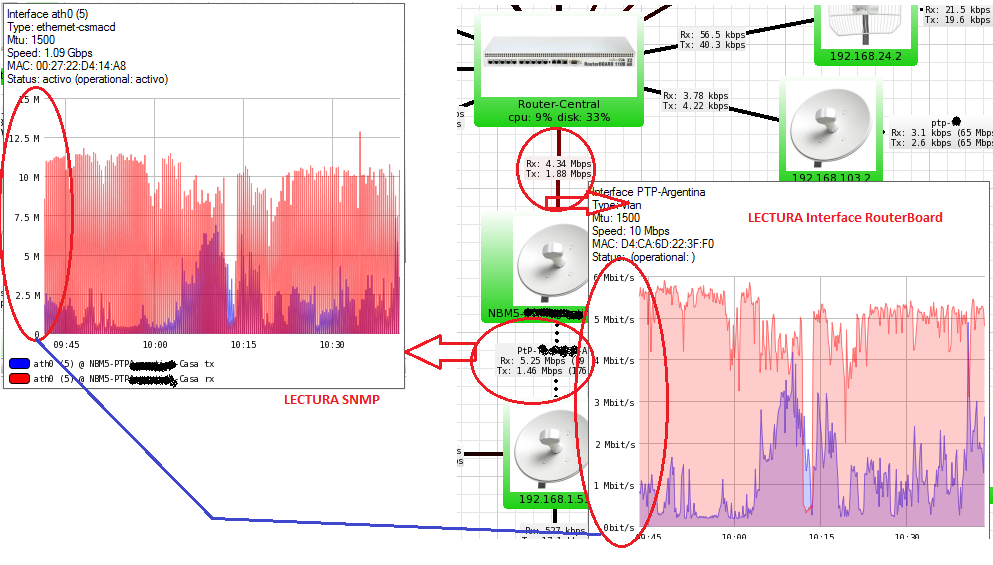

some time I’m using THE DUDE and a few days ago appeared a problem with snmp graphs.
The graph shows the consumption*2 (twice).
Is this a known issue or am I doing something wrong? look the picture…

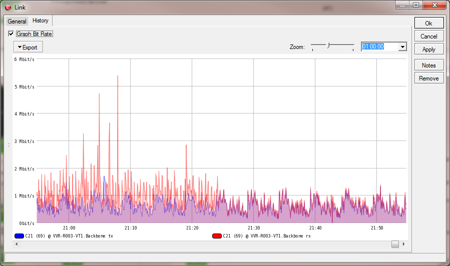

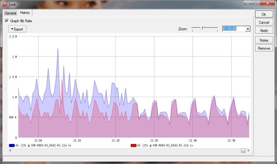

same traffic, two different Label Refresh.
5 sec Label Refresh:
30 sec Label Refresh:
Sebastian
Hi, all!
Have same problem ![]()
Can anybody tell me, how can i get correct graph bit rate??? It’s possible?
