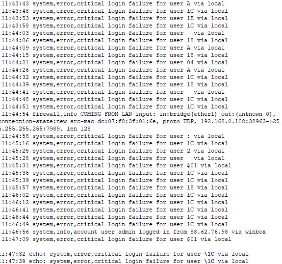

Hello to everybody,
i have a problem in my configuration of wAPGR LTE.
After configuring each of them i start to see strange error in log.
“login failure for user (here there are symbol or single letter) via local”
I though was the LTE, so if i reset the USB from the Routerboard menu, i stop to saw thi error.
As you can see, this happens quite a lot. I forgot something?
PS. apart of this strange behaviour, all the things are working fine, including LTE.
Somebody/something is trying to get into your device.
I hope your firewall is ok …

This is not an export of config ?
Looks like a script to set config.
What ROS version are you using ? (I assume ROS7 since I see BTH )
add action=accept chain=input comment="Access from public " \
    src-address-list=Pubblici
Do you really need to have ALL ports open for that public access ?
If Winbox, only use that port (better: change the port for winbox access and use that one).
And yet again better: only use a vpn to get in (you have BTH, it’s meant to be used for this). Don’t forget to add VPN to LAN interface list !
Hello, no i don’t even need this but i’m closing all ports after i can check that everything works correctly.
I already have some of them installed, with no more open port to the public, apart 8291
I’m on 7.17.2 version, arm.
is user via local, not user via winbox…
nothing to do with firewall, winbox port, internet, etc.
One hint (apart local)…

Ho il sospetto che, siccome la RouterBOARD wAPGR-5HacD2HnD non ha porte seriali,
veda la porta seriale per i comandi AT del modem EC200A-EU come una seriale per il terminale,
e, quando arrivano i parametri dalla porta del modem, li interpreti come username e password per l’accesso.
Disattivando la console su quella porta, dovrebbe smettere.
Thanks rextended.
At the default configuration, the only port that the device sees is the USB1, after removing the configuration, it creates the serial, how can i come back to USB1? Thanks
PS.
i remove the port from system console and everything is ok now.
Thanks a lot.
I still have some doubts about name of the ports and why routerboard creates a console from that port.
@rextended ho risolto su di un dispositivo facendo l’export verbose come consigliavi, c’è interesse che lo faccia su quelli che mi rimangono con l’errore?
Il nome della porta è solo un valore testuale o ha un significato? Perché di default si chiama usb1, mentre dopo il remove configuration si chiama serial0.
Grazie mille
 system/console/export verbose

15:43:38 echo: system,error,critical login failure for user \1C via local
una volta rimosso da system console tutto è andato a posto
