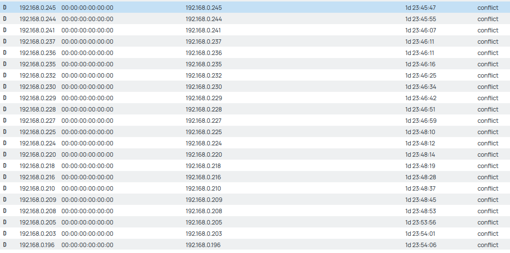

Hello community, I recently had a Mikrotik dhcp warning, “Detected conflict by ARP response for ….” and the DHCP leases reporting “conflict” as status and MAC address is always 00:00:00:00:00:00.
My research points to it being ether a rogue DHCP server on the network, or proxy ARP device.
I tried these steps:
  1. Check for devices with static IPs: Look for any devices with manually configured static IP addresses that fall within the DHCP pool's range and remove the static configuration or exclude the IP from the DHCP scope.
  2. Examine the ARP table: Go to IP > ARP in your MikroTik router. Look for any IP addresses listed with a "00:00:00:00:00:00" MAC address and try to identify the conflicting device.
  3. Check for other DHCP servers: Ensure there isn't another DHCP server running on the same network that is competing for the same IP addresses.
  4. Clear ARP cache and reboot devices: If the issue is with a device that has a dynamic IP, try clearing its ARP cache and then rebooting it. You may also need to reboot the MikroTik router to clear any stale information.
  5. Inspect the DHCP server settings: On your MikroTik, enable "Conflict Detection" in your DHCP server settings if it's not already. Also, consider enabling "Add ARP For Leases" on the DHCP server and setting ARP mode to "reply-only" on your bridges to prevent the router from sending ARP queries and to ensure it only trusts its own ARP table.
  6. Use a packet capture: As a more advanced step, you can use a packet capture on the MikroTik and filter for udp port 67 or 68 to see what devices are actively requesting or responding on the DHCP ports.
I have tried searching using Wireshark and Torch to search for dhcp, bootp, udp 67 and 68, and not found any conclusive device that is broadcasting.
and updated the DHCP defconf settings to “Add ARP for Leases” and “Conflict Detection” options to checked.
On bridge set ARP setting to “reply-only” and DHCP Snooping is set to on.
This conflict only began two days ago, and is completely bogging up my dhcp system.
Any gurus feedback, ideas, experience is most welcome. Thank you.
I figured out a workaround for now. Wrote and scheduled a script that cleans up all status = conflict every 10 seconds. I still need to understand WHO the rogue dhcp server/device is with no mac ie 00:00:00:00:00:00.
I am open to suggestions how to determine this conflict anomaly from MAC 00:00:00:00:00:00. :slight_smile:
