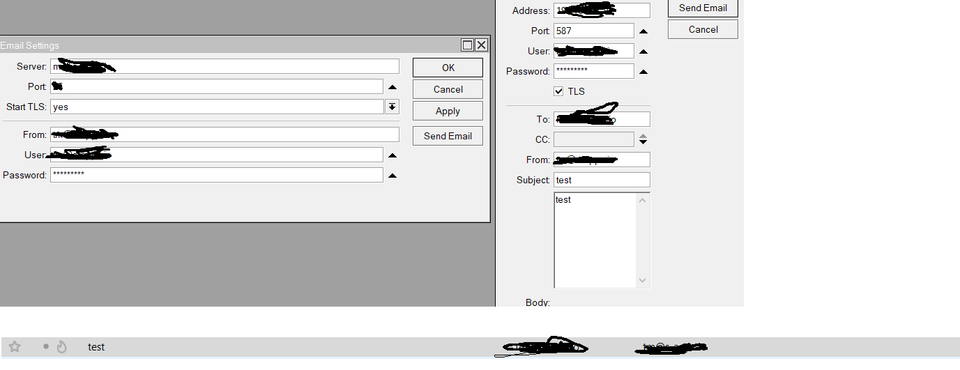

I added email settings via Tools > Email and then in Send Email. Its working perfectly when I send email (see snapshot).

Second: on picture you use different settings for sending test mail…
You do not think to use THAT settings on main settings?
start-tls=yes ≠ start-tls=tls-only
I tried with tls and without tls. The thing is its sending email when I press send email.
