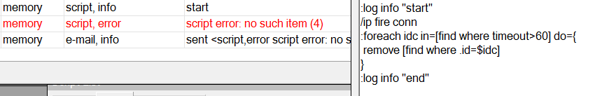

still paste this on winbox, and I do not give any error:
/ip fire conn
:foreach idc in=[find where timeout>60 and (!(dst-address~":8291\$"))] do={
    remove [find where .id=$idc]
