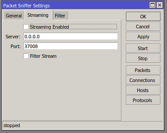

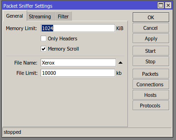

The only option you have is start a packet-capture on a RouterOS device and “stream” this towards any IP endpoint further down the network.
On the remote end you either have some Wireshark running or probably some tool will exist to then write a pcap-file locally. (eg. rpcapd.exe)
