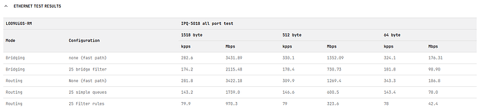

I doubt that there will be much difference. The L009 doesn't have the CPU resources for 1Gbps (at least not with 25 firwall rules and 512 byte packets).

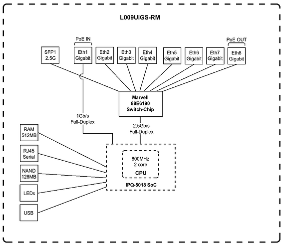

I am not understanding, on the L009 the SFP Is connected to the switch chip, just like ethernet 2-8, it looks to me like the opposite of case #1.

The "channel" between the CPU and the Switch chip is (according to block diagram) a 2.5 Gb/s (please read as 2.5x the speed of the 1 Gb/s one connecting ether1 to the CPU), and - as rextended posted - the "normal" configuration, if WAN is SFP, is to use the one and only SFP port (that is connected directly to the Switrch chip and thus is connected to the CPU through the same 2.5 Gb/s link).
The 1 Gb/s of any "other" port is connected to the CPU through this 2.5 Gb/s link.
If there was such a penalty when using (say) ether8 as WAN, this same penalty would be applied to the SFP port.

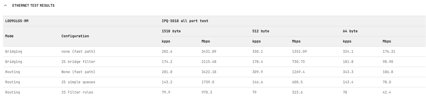

In any case the actual throughput of the device is lower than what would be saturating the 1 Gb/s of the ethernet port, if we use the normally used reference of 25 rules, 512 b packet, it is:
Routing 25 Filter rules 323.6 Mbps
even with fasttrack or whatever other acceleration enabled, it won't probably exceed, in good days, with strong tailwind, 600-700 Mbps, maybe 800.
So, as I see it, using any of ether2-8 as WAN likely won't change much unless - at the same time - the switch chip is saturated by LAN traffic (but if this is the case, this would also be true is SFP is WAN).

Reason: There is a separate data path for the traffic between the ISP and the CPU. If going through the switch, it becomes a "Router on a stick", and all traffic must share the link between the CPU and the switch (although it has a bigger 2.5 Gbps pipe). About the only time that the 2.5Gb link would be a bottleneck is if there was a lot of inter-vlan routing being done, and in that case, I think the CPU would be the bottleneck before the 2.5 Gbps link, that's the reason I don't think there would be a significant difference.

If we put aside CPU in L009 being unable to keeep up with 1Gbps WAN, the difference between using CPU-connected port for WAN and switch-connected port for WAN is in utilization of CPU-switch interconnect.
In case when WAN us on switch-connected port, every packet has to pass the interconnect two times (once for LAN-routing engine leg and once for WAN-routing engine leg). If everyting was up to 1Gbps full duplex, this means 2Gbps full duplex on interconnect. If interconnect is 2.5Gbps full duplex, this leaves 500Mbps for any other traffic which has to be handled by CPU (e.g. ROSE or WiFi).
In case when WAN port is on CPU-connected port, every packet passes the CPU-switch interconnect only once (on LAN-routing engine leg) and leaves 1.5Gbps full duplex to other CPU-handled traffic.
The above really only fully applies when CPU is capable of handling lots of traffic ... which in case of low-end devices (such as L009) is clearly not the case. But might be true for mid- and high-end devices (such as 5009 ... which doesn't have any CPU connected ports so it's a completely different beast).
So when considering which is the best option, it's necessary to consider actual device performance and block diagram ... or go with MT defaults for sake of simplicity.
